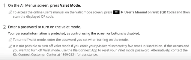

Thank you Adam, I tried both ways, none worked. Attached is what I see on the screen.
I also took my car to a dealer and they told me that they don't support American cars. And mine came from America.
