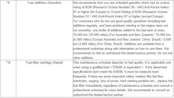

Even the most basic of concepts of octane ratings you get absolutely wrong. For you folks down under, Kia doesn't recommend 91, since your octane ratings at the pump are denoted in RON (Research Octane Number), same as in Europe. Here's the exact verbiage:
"For the optimal vehicle performance, we recommend you to use unleaded petrol with an octane rating of RON (Research Octane Number) 95 / AKI (Anti Knock Index) 91 or higher. You may use unleaded petrol with an octane rating of RON 91~94 / AKI 87~90 but it may result in slight performance reduction of the vehicle. (Do not use methanol blended fuels.)"
Source:
https://www.kia.com/content/dam/kwcms/au/en/files/owners-manual/kia-stinger-owners-manual.pdf
Here in USA and Canada, our pump numbers are in AKI (Anti Knock Index), which is (RON+MON)/2.
FWIW, 91 RON is equivalent to AKI 87. 95 RON is equivalent to AKI 91. So for Australia, Kia's recommendation
is for premium 95 RON gasoline, for optimum performance.
