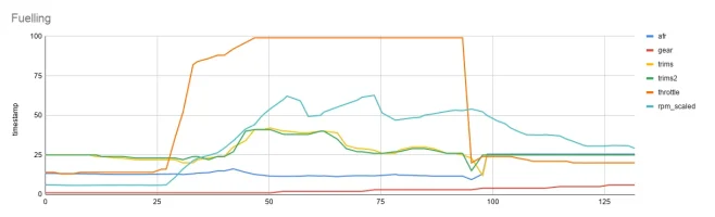

Fuelling looks fine, AFR is pretty solid, trims are clustered, but seem a little low in the shift to 3rd?

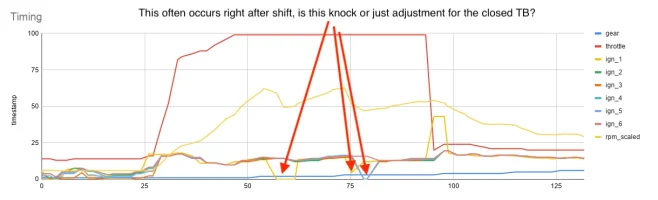

For Ign_1, I see it's often out of sync with the others, i.e. it'll often drop to 0 between shifts, while the others stay tightly clustered. Check the following graph, there are a few times it drops after a shift, but there's no obvious feeling after the shifts, and timing stabilizes right afterwards.
There's always something weird with Ign_1, note that it spikes after I drop the throttle, all of the rest stay grouped. Is Ign_1 showing some other sort of calculation that the others don't, or is there something legitimately wrong with it? I heard knock was supposed to be timing pulled in 3.5• increments? These almost always drop to zero, so my assumption is it's just something to do with the recently closed TB during shifts?

@Terry@BMS thanks for the link, I’ve been using that for reference though do see that the Ign to zero after shifts are just that, there was one spot where other Igns other than 1 were bottoming out, but probably just the described sampling issue.
Right, they won't always line up due to differences in how 1 and 2-6 are read by the JB4.
