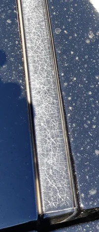

The rubbery roof trim mouldings are unacceptable. I wonder which bright spark was responsible for them.
