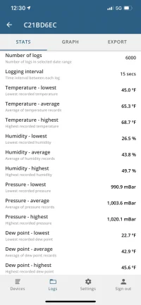

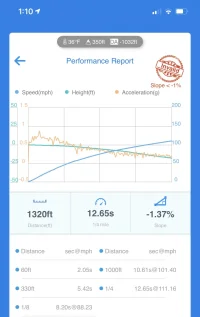

My only performance modifications are the AirScoops snorkels and the AEM drop in panel filters in the factory airbox. Those two simple changes that cost me less than $250 have added 3.16 mph to my 1/4 mile trap speed.

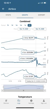

I actually bought a small pressure reading device and put it in the airbox. It showed a measurable increase in air pressure inside the airbox when at speed. It was pretty cool. As long as you weren’t on the gas and you were at speed you could see the ram air effect of the snorkels feeding air into the filters.
Those aftermarket panel filters aren’t actually as restrictive as people think they are. They are actually very close to the efficiency of the equivalent sized cone filter.
I am working on a video that explains everything I have tested so far. I honestly think that the factory air boxes could be a better option than some of the aftermarket open air solutions.
