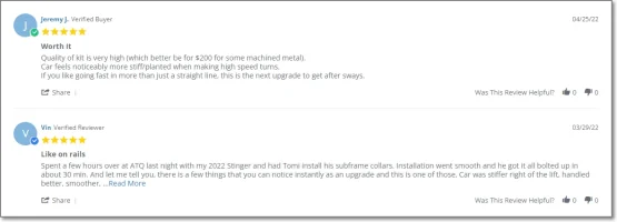

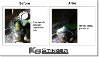

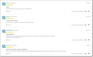

I have to say I'm surprised to hear this, just this year alone we've sold (53) sets of the ATQ Chassis Collars.
The feedback alone on our site speaks for itself. (Every review is verified through a 3rd party as a verified buyer of the product, which prevents false reviews)
The product has a 4.8 star review out of 5.0 stars and almost every reviewer mentions they were doubtful, but after installing they felt a difference.
The product 100% works, as it eliminates the free space between the chassis and the subframe, essentially eliminating the slop/movement and tightening up the chassis.
Please take a moment to check out the (28) reviews from verified buyers on our site below and decide for yourself if you think it's worth it or not.
Kia Stinger - ATQ Subframe Chassis Collar Kit - K8 Stinger Store
Feel free to reach out directly if you have any specific questions I can help with.
