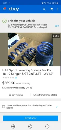

I checked on ebay and this is what I got, this seems legit to you guys?
If they take PayPal you should be safe either way, if it’s a scam PayPal will reimburse you if not you got a good deal on the springs.
