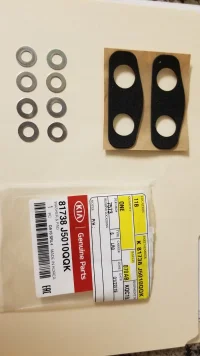

I just got some 2mm Silicone Rubber sheet and made gasket / spacers by tracing and punching some holes and fitted them without any washers at all and it worked perfectly. No more clunk. Took 20 mins total and since there's no washers, there's no chance of metal to metal contact ( which could promote wear and rust ).

I had a very slight rattle coming from the hatch. I bought some 2mm silicone rubber tape and put one piece over the screws on the bump stop as the video shows. Interestingly, my car did not come with washers after removing the bump stops ('23 MY). After installing them back into the hatch the rattle is gone. I think using this method added just enough pressure with the hatch being closed to prevent any movement and sound. Hopefully this fix continues.
This may seem over engineered but for anyone with a 3D printer, this it's a 20 minute solution (and solves that itch to make something!). We can't get the US TSB Kit (thick foam pad, 4 washers) in the UK so I made a 3D model that lifts the guide bumpers slightly. Much more written in my reddit post and also in the thingiverse link:
So if you have a 3D printer and don't fancy a trip to a US Kia dealership or a pair of trips to the art store and hardware store....try this...

It only takes one stainless steel washer under each bolt and screw it back on and it'll never rattled again.
