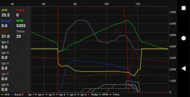

Can someone review the attached log and let me know what you see.
Visual graph
Well after more researching I found information that says ign1 is true timing and all other cylinders are logging adjustments. I have a lot of adjustments high end
Ign1 is your base/absolute timing advance: 10 means 10 degrees BTDC. Ign2-6 are individual cylinder corrections: so 3 would mean (10-3) degrees in that cylinder.
In your log, you just have a couple quick WOT bursts with closed throttle between, but you can see Ign1 increase from 8-9 to around 14 through the rev range. If you did a longer pull through a few gears, say 20-80mph, your chart would show it climb through the rev range and drop after each shift.
Rule of thumb for corrections is that 3+ degrees means knock. So all those 2.3s aren't a big deal, but the 3.8s, 4.5s, and 6.8s may mean you're octane limited. Here's a writeup I did with some more info, and the link to BMS's parameter definitions:
Thank you. I definitely was misreading the log. Also it was hard to find an area to do a full pull. I will try to get better data tomorrow.

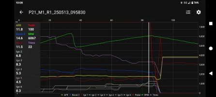

New WOT log. I think it got worse for timing retard.
Yeah base timing, trims, AFR, and fuel pressure all look good, but those 4.5, 5.3, 6.8, 8.3 corrections in most cylinders aren't good.
I do see your ECU calling for as much as 15.1 psi, which I think is on the high end of stock (it's load based, but I'm used to seeing ~12psi in winter, ~14psi summer, and your IATs aren't crazy high at 87 degrees).
What kind of fuel are you running? If it's some kind of crappy California 91, and your total boost is closer to what's typical for Map 2, that might explain things. Can you try another brand of gas, ideally 93?
I'm running the highest octane available which is 91. Unfortunately in my area theres nothing higher.
