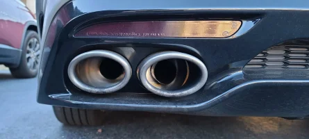

Would that work with this setup? Ngm delta muffler outlet 'floating ' in the oem tip

Shop had to cut part of my back muffler to fit in the tips. Otherwise they stick out. I wanted close to stock and that was the only way. Its an aftermarket exhaust so no biggy. Looks good. Got them from a vendor in Aliexpress. They have so many choices just pick the correct size. Was not that expensive either.
