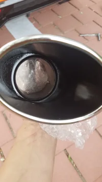

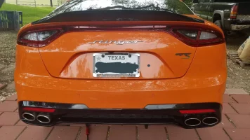

Finally had a chance this afternoon to install chrome exhaust tips on my MBRP exhaust from Aliexpress. Did it to remove drone that was bothering the kiddos while sitting in back.
In the second pic I have the new exhaust tips on the right and OEM on the left... Not much of a difference which I wanted. Painted the inside to prevent rust as well. Forth pic shows how much I offset for inner and outer exhaust tips.
Took it for a drive on the highway and it might have eliminated the drone in the 1750 RPM range but honestly now its too quiet for me

Those look like the same tips I ordered from Aliexpress while waiting for my GT-9 exhaust to arrive. Why paint (except for appearance) because they are supposed to be stainless steel?
Those look like the same tips I ordered from Aliexpress while waiting for my GT-9 exhaust to arrive. Why paint (except for appearance) because they are supposed to be stainless?
Tracking with them being stainless... Do not want any rust forming. I had a bad experience with "stainless" exhaust tips on my truck. They rusted out and looked hideous.
I do think it enhanced the look inside :)

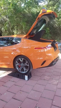

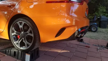

Super easy to install.
Removed exhaust from the hangers in back and middle. No need to loosen any of the hardware on the exhaust itself and was able to do one side at a time.(Used WD40 for the middle rubber/hanger piece)
Then remove the OEM tips with a 10mm socket and Philips screwdriver.
Nice! Thanks so much. So with the hangers off you just kinda wiggled each side out of the way to pull the old faux tips off one at a time?
Yes, then hang the exhaust back on. Installed the tips from outside the bumper. No trimming needed.

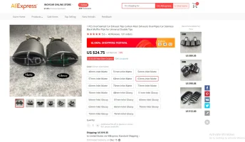

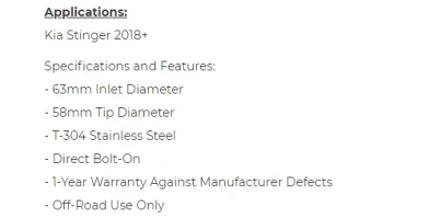

Can someone help me out with figuring out what dimension tips I'm supposed to get? I have a Megan Racing Exhaust and on their website they say that the inlet diameter is 63mm and the tip diameter is 58mm.

Read my post on this thread - #817. Looks like you got the right size selected but you can choose different finishes as well.
