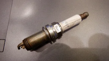

An update: I've done a launch, couple of days ago, and of course the usual "passing fast". The launch (done flawlessly: stability and traction control OFF: Sport, in automatic transmission position, i.e., not manual gate: push brake, then gas, let off brake and hit kickdown switch) was accompanied by a "lumpy" sensation, as if the tires were running over close together asphalt repairs/ridges, or uneven concrete: what it was, of course, was something misfiring, probably in one cylinder. A bit later in that same ride, as I entered the freeway from a cloverleaf, moved to the left and accelerated very briskly (but not quite kickdown switch brisk), I felt the same hesitation and saw my first-ever CEL icon: it went away almost as soon as I backed off to civilized throttle input: haven't seen another CEL icon in the last two days: this afternoon I pulled out to the left of someone on the onramp in front of me and pushed down pretty hard (again, not quite kickdown switch hard), and my wife said, "What are we running over?" She felt it plainly. So, I will be making a trip to the dealership as soon as possible.

Cracked plug:
This is one of your new plugs from the last service?
Yes. I'm so lucky. The only TPMS sensor to fail in a year and a half that they've seen where I get my wheels and tires done; and now this, hah. I was the memorable service appointment today. :D
