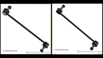

How is your old removed OEM end link bent?
Bent how? Can you share a pic?

Kinda weird - they are listed as different parts, left and right? 54830-J5000 (left) and 54840-J5000 (right)? Aren't they interchangeable? I just took the straight one and put it on the driver's side, and had no issues (as far as I can tell - I've only gone for a quick 1/2 km test drive).
Also interesting that they want $75 / $65 for one endlink (although I can find them for $42 each on ebay). The godspeed adjustable endlinks are $60 on ebay for a pair.. Is there really a left/right difference? What is different?
Apparently ... Slight difference in the angles between top and bottom... I have never tried putting the wrong one on the wrong side
Yeah, those Rock Auto ones seem like cheap replacements that are probably almost as good as OEM. I know the MEVO ones were a huge "must get these - way better than OEM" in the Subaru community for about 1-2 years until they started failing..
A little googling seems to indicate that the bent one (which has IK/CK-LH on it) is the driver's side, so I have now put the passenger side endlink over on the driver's side. Oh well. I'll see if there are any clunks or squeaks. But it does make it a bit more likely I'll get another set.

I find that highly suspect. For two reasons:
1. Looking at the pic above, the only possible failure mode is via first buckling mode. The unique characteristics of this pinned buckling mode is that the stress on the buckled rod is fairly evenly distributed over a large portion of the length of the rod. it will take a great deal of deflection for the stress at any one particular point to exceed the tensile strength (elasticity limit) of the steel member and form plastic (permanent) deformation.
2. The typical steel alloy's Young's modulus of elasticity is some 29,000,000 psi. These OEM end links more than likely are even stronger steel alloy and heat treated per the application. Even hitting a biggest pot hole from hell will likely damage your tire and wheel long before it would stress that OEM endlink enough for cause permanent deformation.
3. Furthermore, one end of the endlink is acting upon a torsion spring that is the anti-roll bar. This torsion spring constant is by design many orders of magnitude softer than what can buckle the end link. Even with the typical aftermarket bars. Any load imposed on the endlink is translated into the torsion spring, whose very deflection lessens the likelihood of the endlink buckling. This - by itself - basically eliminates the possibly of endlink buckling. The only possibility is if the anti-roll bar is not installed correctly, such that the bar binds up somehow and cannot behave normally as a torsion spring, thus concentrating the buckling load onto the endlink.
Fact is, I've got 3 Stingers/G70 all running Whiteline anti-roll bars and OEM endlinks. These cars have been repeatedly put through some seriously paces for some 3yrs now. And I've hit my fair share of pot holes from hell as well. Not a single endlink - out of 6 - have failed from buckling, and I just don't see it happening... ever. No doubt the end ball joints will eventually fail, and that is what I would expect.

I don't disagree with that assessment - so are you saying it was most likely bent from the factory? I mean, it got bent SOMEHOW. I did hit a few potholes, but these were only only the car less than a year, IIRC (June '19 to March '20).
Or are you saying you suspect someone botched the disassembly?

I don't know exactly the sequence of events that lead from your car being stock undamaged to you being handed an OEM endlink that looked like that. All I can say is that a properly installed OEM end link being driven "normally" - even with potholes and HPDE - isn't at all likely to suffer that sort of damage. I also do all my own wrenching, so that eliminate the possibility of things done to my car that are unknown to me.
I'm certainly not going to accuse anybody of anything if I don't know the details. But I can tell you - in my own experience - I've had my brand new unused spare tire swapped out with an old worn one, after the car spend time at a body shop for collision repair. The same repair shop also tried to return the car back to me with one of the wheel's paint all peeling and coming off. No freaking idea if somebody there pulled another switcheroo (like the spare wheel), or they botched up a cleaning job with harsh chemicals. In the end, I got them to swap out the damaged wheel with a pristine one. In short, if the car was worked on by anybody other than yourself... all bets are off.
