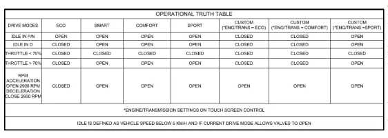

Does this table apply?
From
ww.stingerforum.org/threads/kias-bimodal-exhaust.1640/post-21013

This doesn't appear to apply to my June 21 build GT1. I really can't really hear any difference in sound between comfort and sport at the same RPM in the same gear, whether on the highway or at idle. I know the valves open and close, I can see them open when the engine is off and I can see that they're closed when the engine is on. It also seems like when weather is cold and the car is sold that the valves DO stay open when I first start the car.
