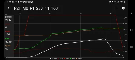

I've seen references to HFPF "crashes", but what does this look like in the logs? Is it just FP_H starting to drop from 10 to 9 or 8? "Crash" makes it sound like it plummets all at once. Any indicators you're approaching a crash?
That I don't know. I've never mixed that much, just read about it. From the sounds of it, it drops drastically, not just a few percent.
Below is an example of when I had my pump crash while working through CPI/ ethanol issues.
The darker, bottom red line is the pump crashing. Essentially, the vehicle is not able to keep up with the fueling demand and it cuts the fuel completely. It is very abrupt once the "crash" has happened, and it feels like you hit a brick wall. Sometimes the car will cut the boost completely as a result of the crash or too many crashes. Too many crashes and you can damage your fuel injectors along with other components. It's very unhealthy for the car.
With the JB4, I believe the value for the crash is once HPFP drops under 7. Normal fueling and pump keeping up with demand would have a value of 9-10.
This is great, explanation + chart is really helpful. So below some threshold pressure (say 7), the car's ECU decides it's better to cut fuel entirely than run lean (or maybe risk burning out the HPFP)? And do you know if it does this by deactivating the injectors, or the HPFP? I'm assuming the latter since you say the crash is bad for injectors...
I can't answer about how it cuts the fuel, but yes, the car is trying to save you from having a catastrophic failure.
Another thing is that sometimes that HPFP value dropping is happening over the course of only 1-2 seconds. So, the graph may not illustrate how fast it's dropping. But the log (CSV file) is better for that. For that particular crash, the car went from a safe value (9) to crashing (7), in 1.5 secs. So as I said, it is very abrupt when it cuts. You will not like it.
