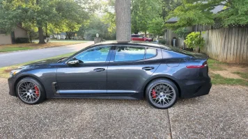

Thanks SRV! So if they were to maybe fit...they would need a greater offset. I think the seller said the rears were 45. I thought it might be a stretch. I have found some that have done it during a simple google search but not enough info for me to drop 2500 on a set to find out they dont fit.
lol, you need a shot from the rear, since this is about fitting rear wheels. go out and take a hard down the side shot from the rear, you're doing it for the team.

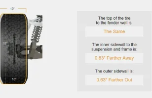

Use our wheel offset calculator to visualize the new tire position when changing wheel and tire sizes. Convert wheel offset and backspacing to calculate the correct setup for your vehicle.
tiresize.com
Plug in the stock wheel and tire sizes, then your new ones, and then look at how they'll fit relative to the originals - it's a really nice tool.

I will mess around with that wheel offset calc. Thanks for sending that!
Actaully...I think I like the Aodhan DS08. It seems to me that both my tires would fit on the rims and the wheel would fit in the spaces. Hopefully someone will chime in....thanks SRV!! The look you had going in the pictures is the where I would like the tires to sit. Wondering if with this set up the wheels will look as agressive as I am looking for. Wish they made the rears in 10" vs 9.5"
I am not really sure what I am checking I guess. In some cases it shows 0.47" further away and out...I suppose I should go measure where the tire is at reletive to the fender. But then I start thinking about the brakes..,..
