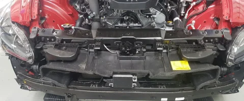

@StungBlueGT2 & @Hyperjetta, have you removed the factory snorkels? I bought an extra set of airboxes and did some modifications over the weekend to them thinking it may help, but after looking at the factory design, I'm with @SteveCo on how it works.
The factory airbox is completely sealed all the way from the airbox through to the snorkels. The engine, therefore, pulls air in actively. Air won't actually blow in, like it would with the Velossa Tech scoops installed. I can't see any way that air would actually flow from the factory snorkel into the area where the airbox is, without the entire pathway being completely sealed.

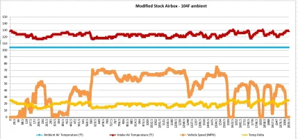

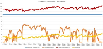

So I bought an extra set of OEM airboxes off eBay for $125 and decided to modify them by drilling them out and removing the little reducer/mating piece in the front that connects to the snorkel. The idea was that it would open it up quite a bit more and allow more flow. See attached pictures
I also did some IAT logging both before and after the modification on two separate hot days going to and from work (morning was ~85F and afternoon was over 100F). I'm attaching the graphs to show the difference. Overall the modded airbox seemed to perform better with an Average IAT vs Ambient delta being around 19 degrees. For the Stock airbox, the average delta was worse, at 22.5 degrees (IAT vs Ambient).
Highest IAT recorded on the modded airbox was 131F (against a 104F ambient) vs the stock airbox saw 142F (against a 108F ambient)
The two graphs plot time (in seconds) across the bottom, vs speed, IAT, Ambient Temp, and IAT-Ambient Delta. Total commute is about 45 minutes for each plot.

I finally got around to pulling my bumper and taking a look at those snorkels. I took some rough measurements and found the inlets to be ~10.5 cm x 4.5 cm. This comes out to an opening area of ~47.25 cm^2 which is a tad bit higher than the opening area of the 3" diameter piping (pi*(38.1 cm * 38.1 cm) = 45.6 cm^2).
So, unless I'm not accounting for something the stock snorkels aren't really a bottleneck unless we upgrade our piping to something bigger than 3".
