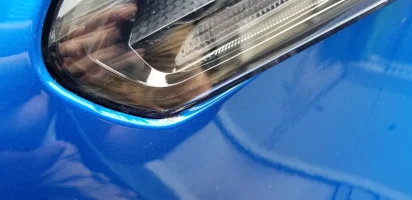

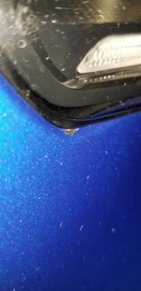

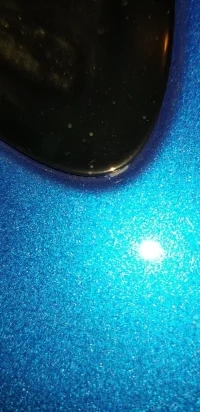

I think my blue stinger is suffering from this paint chip problem. Some of the chips look like it *could* be caused by rocks getting kicked up except for this one spot under the drivers side headlight that couldn't be the case, it's almost like the paint is peeling away.
People who have this paint problem happen to them does this look anything like yours?

How long have you had your Stinger? What is the build date? If this is all that is going wrong with your paint over an extended period of time I'd say you're good. PPF while your car still looks good in front. Watch the rest for signs of non impact flaws.
(edit: the headlight assembly problem: yours looks very small, especially if it has been going on for quite a while. I wouldn't expect it to get any bigger. In the pic that looks more like a chip/flake rather than a peel away. The rubbing headlight assembly issue produces a range of effects, from nothing visible at all, through actual peeling away, i.e. complete paint failure.)

Aside from the headlight peeling defect this doesnt look like the typical faulty blue chipping paint. The one that goes to black plastic is likely a rock, i have one of those. The last pic looks like a partial chip (clearcoat only or half way through the paint) unless you touched it up already. The faulty paint blue chipping almost always will chip to what looks like bare metal with no signs of impact. I have lots of these. Unless you touched up the chip ill guess you have a 2018 bulid date.
Just checked inside the door jam and it says 1/18. I picked up the car at the end of March and its at about 4500 miles now. I haven't used touch up paint on any marks/chips on the car. Just surprised at all these marks with such few miles in 5 months of driving in New England spring and summer months.

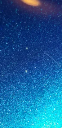

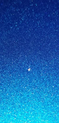

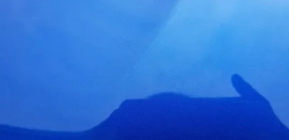

I went though most of this thread's pages and they look similar to other pictures in this tread, maybe just a bit smaller. I took some closer pictures as I don't think my original pictures do justice to what it looks like. Also it is a micro blue GT, I think most of the other blue stingers in this thread were 2.0's?
Picture 1 is the headlight area does look more like chipping than peeling which could be caused by the headlight rubbing
Picture 2 doesn't look like it goes down to metal? Or am i mistaken?
Picture 3 does look like it could just be the top clear coat. Since I have this picture I could monitor it if it get any worse.

Those pictures are better. 2 and 3 look like the typical blue chipping. Time to open a paint case.
Agree. It won't hurt to start now, start slow. :cautious: Kia will always, always, always, be more than happy to back off a case if given "permission". But they won't run from one.
What I am saying is that, if this is as bad as your car is @Deaddudehangin, after more than half a year of life, it might not get any worse: and it might just start showing more signs, but don't borrow trouble. If you feel that your paint looks good enough to protect and will likely stay that way, then just ask for warranty work. Get your dealer to check out your paint flaws, and this thread, then make a decision: if they decide it isn't road damage, you're "in". Get the few spots repaired and then PPF/ceramic the heck out of it.

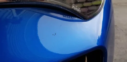

But I was looking some more with a light and found this under one of the vents, would never of found it if I wasn't looking with a light. Ya idk what this will do after a few year/a salt filled winter so I rather get it taken care of asap. Funny part is I bought the extended warranty and I could of sworn they said they were putting a protective coat over the car, which was why I had to wait an extra couple of days to get the car.
Either way I'm going to call the kia customer service number tomorrow. Unless someone knows of a better number to call?

Kia will just tell you to take your car to a dealer for examination, which will probably include pics taken by them, etc. But, it's a start.
