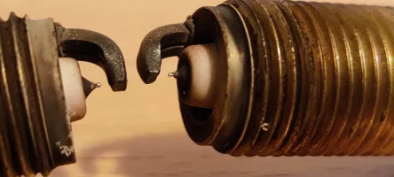

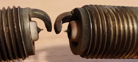

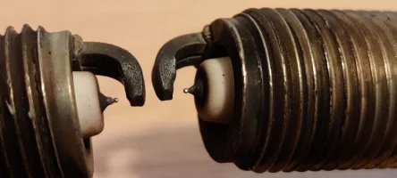

Just changed my plugs (Densos) after 20K miles, here's what they looked like.
Gaps were:
.027
.028
.028
.028
.030
.030

They're not "toast" but I'm gonna stick with 20K max replacement interval.
Look at the middle left pic, that electrode is getting super thin and I wouldn't want that little ball tip breaking off and going for a ride in my engine.
.022 original gap.
Yes I replaced with same plugs, The Densos perform well enough with the correct gap.
