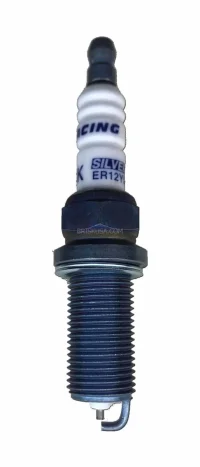

Here are pics of the plugs I'm considering, just for fun...
Brisk ER12YS:

Those NGK's ain't cheap, though... So I will most likely just try the Brisk plugs.
Yeah those -9 NGKs are expensive for a plug. I've ran brisk silvers quite a bit and had no issues. Now if you go bigger turbo I don't recommend them as they can cause a bit of timing pull up top. The rule of thumb on plugs is for every 100hp, go one heat range colder. The RS7 plugs are priced well and an 8 heat range but I want to test them myself before saying they're worth a buy.
