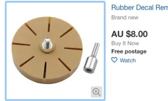

The reason why people on here are wrecking their paint is because you guys are using bloody heat guns :mad:
Just use a hairdryer get it warm only as the tailgate is plastic and nose is rubber (well not rubber), just take your time using fishing line is ok but make sure your pulling towards you as you saw away at it. The best way to remove the glue and tape residue is a pinstripe removing wheel..it's made of rubber you put it in drill and lightly apply pressure while spinning of course to glue or tape and bingo watch it all come off not one swirl mark even..we used this method always when i worked in Panel Shop (body shop)...get it on ebay :thumbup:
I actually managed to ruin my paint without applying heat (i avoided it for the reason you described but now realize maybe using a blowdryer wouldve been the right call). But thanks for the tip on removing the adhesive. I got a good bit of it off but there is are still discernible patches of residue.
