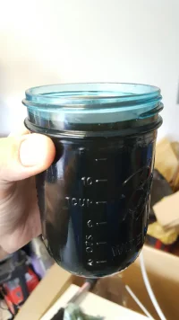

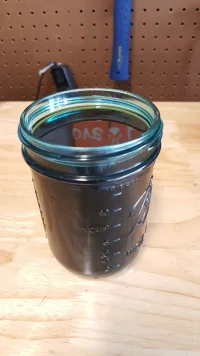

Here's how much oil I pulled out of the Stinger. This brought the level DOWN to the Full mark with the oil completely warm. In case you can't read the markings, it's just shy of 2 cups, or a 1/2 quart (U.S.).

Yeah, I usually use Royal Purple, but right then I was worried about pulling too much out and having to put a little back in. I didn't want to mix normal and synthetic.
