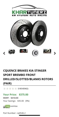

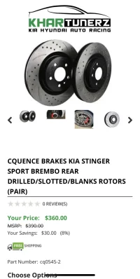

Please reed I did post that they are different look at post #110.
Also please see pictures I’m just giving the prices they give me.
