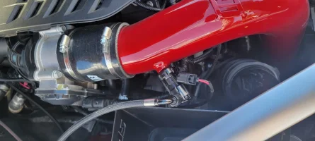

This is where I installed it on my IMR intercooler kit. I had to weld in the 1/8" NPT bung as it doesn't come with one.

I installed the Agency intake before CPI was a twinkle in Terry's eye. I pretty much put in the same spot as @Andy B
The slight difference is the Agency has the 90 deg built in, meaning there isn't a separate connector to to make that turn. It's all aluminum and I drilled and tapped 1/8 NTP. The drill and tap kit is under $20 but I already had that stuff. The aluminum was well thick enough to support several threads so I was confident. Sorry about the 90 deg flip on the photo, seems the portal is doing that.20220414_170204.webp

The new ones come with it, but it's much higher up on the charge pipe as Darrin was saying. From what I remember reading, you'll have better performance if it's further away because it has more time to atomize? You may be able to request they install bung lower, I'm not sure.
Install is easy though if it's higher on the charge pipe. You don't even need to take off the bumper.20220928_140850.jpg
Install is easy though if it's higher on the charge pipe. You don't even need to take off the bumper.View attachment 75116

How's the cpi run with it so close to the t body? Any issues since install? Most have it as far away as possible from there.
