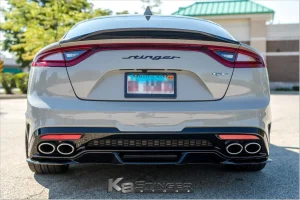

Update. Got the new lights installed. Loving the look! A big shout out to Mangimadang for the lights!!! Thanks again brother. Side note, I can swap the lights but can’t upload pics correctly ‍♂️2E35E296-A5E3-4136-B224-AA50624265BA.webp

Update. Got the new lights installed. Loving the look! A big shout out to Mangimadang for the lights!!! Thanks again brother. Side note, I can swap the lights but can’t upload pics correctly ‍♂️View attachment 75000
How hard was it, cuz I mentioned my struggles trying to go from 2020 - 2022.
I still gotta set of 2019 tails for sale if anyone needs!!!!
Center light was kind of a pain. The middle part of the light didn’t want to seat right, but I got it handled. Turn signals were no problem at all
I feel that taking the painted parts off the old turn signals to transfer to the new lights was a complete and total pain to do and not damage something. I think I broke a tab or 2 doing that part …
Yeah thinking back that was a total pain in the ass to not break something. I guess I was so focused on the center light I completely forgot about it lol
If y’all know of anyone looking to buy the 22 style LED tail lights hit me up
