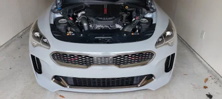

I truly appreciate all of the input ... the fact that this thread is still getting input even after almost 3 years is quite amazing. 16,000 miles on the Stinger ... added an Adro Carbon Fiber kit and then put on carbon fiber: shark fin, gas latch, and spoiler.
