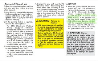

Since I also always use auto hold, the EPB engages automatically
I couldn't remember if it was Park, parking brake, or both that engaged automatically...are you saying the latter will only auto engage if you have brake hold on?
I believe that is correct.
I believe the parking brake (EPB) automatically engages, only if you had auto hold enabled during that drive cycle. Otherwise the parking brake does not automatically enable itself.
EPB is automatically applied, if the AUTO HOLD feature was used, as soon as the ignition is switched off.
It is my "modus operandi" or SOP, standard operating procedure.
Pressing the engine stop button, while in reverse, with auto hold enabled.

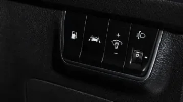

The dash to the left of my steering wheel where you pop the gas door and adjust the dash brightness has my Lane Keep Assist button (2nd from left below), which I've never really used.
The right side of my steering wheel has my Lane Follow Assist button which I use constantly (and I recently discovered if you hold it, LKA will activate separately, although it's redundant if LFA is on). Bottom left button below.

- Lane Departure warning just beeps at you when you're about to cross the lane line.
- Lane Keep Assist (car between two lines) will only intervene when you're about to cross the lane line with brief corrective steering.
- Lane Follow Assist, formerly Active-LKA (steering wheel between two lines) will continuously steer the car to keep it within the lane.
LKA is the older system and only active above about 35-40mph. If you take your hands off the wheel you'll just blindly barrel ahead until the car has to yank you away from crossing the line, so it's really just a corrective feature and not even partial self-driving.
Kia has changed the functionality and names over the years, so it may be that for your year everything was called "Lane Keep Assist", and for the lower trims it just did momentary correction (what LKA does now) while the upper trims got Active LKA that continuously steer (what LFA does now).
