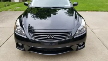

i did the 2 chrome strips above and below the grille on one of my old cars ... before and after

Both of those options look good!!
