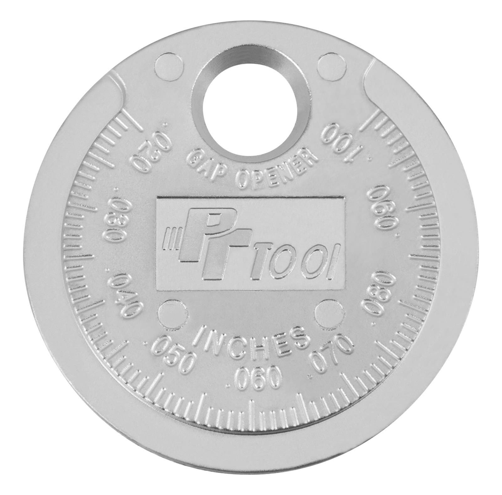

30 mins start/finish for 2.0 and that includes gapping of plugs (taking your time). No excuse for NOT replacing stock plugs. You will thank yourself and your engine will too!!
