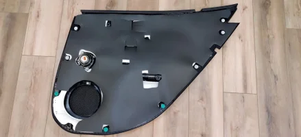

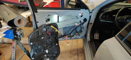

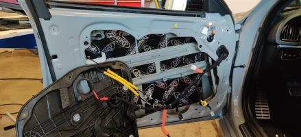

Also have you removed the plastic panel on the door to be able to deaden the door skin?
I deadened all four of my doors, plus added MLV behind the door card.
It makes a substantial difference in the amount of noise coming in from adjacent cars. There was a bit of midbass improvement, but I was too lazy to take measurements.
I would definitely recommend it for the noise suppression alone.
Did you have to remove the glass? Any tips or tricks to taking the inner door panel out?
yeah ill be doing this as well , but using resonix and some black hole tiles up front in the doors
