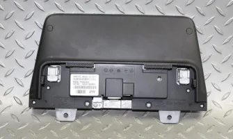

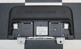

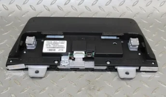

So has anyone with a base GT thought about swapping their 7" touchscreen for the 8"? There's quite a few floating around online from scrapped/wrecked Stingers and while I can't confirm the plugs are a direct swap for fitment, it appears that way...

I’ve so wanted to do that. From what I thought I’ve read is that you still have to take the car back to the dealership to have the new display “programmed” to the car. I could have read fake news though.

It's feasible but we won't know until someone buys a 8" screen and goes for it. lol.
Since it's larger, its possible it could be running a higher resolution, which if that's the case, would explain why the car would need to be "coded" for the bigger display.

I was under the impression the head unit would also have to be changed. From what the dealership told me they dont have a way to flash new software and firm ware onto the installed head unit.

the 8" screen really doesn't add much functionality to the 7", honestly probably not worth the time unless you get one off ebay cheap. you could always re-sell if it doesn't work. I would check the pinouts on both to make sure- just because the plugs FIT doesn't mean they're the same pinouts.

I still suspect the 7" and 8" displays could be plug 'n play "hot swappable".
there's only one pinout in the service manual, so you might be correct on the hot swap. I honestly don't see much difference between the two displays, so it could work. if not, pop it back on ebay where you got it...

I'm am in the process of doing this. Mostly on the FB groups for updates. So far, the pin out is mostly the same. 2 wires are different on the lvds cable. When I plugged the 8" in it turns on but no touch function. Couldn't get dealer to confirm if firmware is needed. Makes no sense why it would being that the pins are the same just different in order. You need a different dash trim also.
