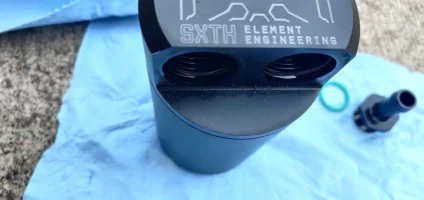

One of my catch cans began smelling a few weeks ago. Definitely crank case vapors smell. You can even see some residue/oil film on the outside of the can where it's leaking...
I've ordered replacement o-rings. Hopefully they'll stop the stink. You can really smell it through the vents when I first start the car, it's pretty dang annoying.

I forgot to post it here.. After replacing the o-rings both on the nipples and the bottom section of the can, I no longer have any vapor smells. I'm a happy camper now. I have plenty of extra of the smaller o-rings for the nipples if anyone needs some.
So you were having leaks at the rings on the input output nipples as well as the big on on the can? I have a new can on the way due to mine being mis-cut which resulted in the bottom part of the can immediately contacting metal on the top part instead of seating agains the O-ring and sealing.
I wonder if they got a bad batch and/or installed them too tight on the nipples? Trying to figure out why you had to replace them since we don't mess with these during normal maintenance with the catch can.
I only saw evidence of a leak on the front can, input nipple. The o-ring wasn't seated properly, I assume it was an error during assembly. I decided to just replace all o-rings, large and small. I took everything apart to inspect it all, and I figured new o-rings all around would be a good thing.

I have the smell too. I have the ADD W1. A month ago I added some high temp thread sealant and that helped a lot, but there was still a bit left. I pulled off the catch can bottom and noticed the large o-ring was rather loose, so I ordered up a new one this week. Once I get it on the car I’ll post an update.
