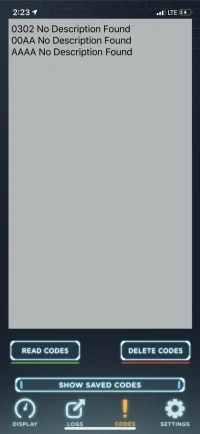

Shaking doesn't tell me much. Are there fault codes? If so what codes?
That is so weird. You just started the car and already misfired? You haven't run the car WOT yet, right?
Here are the codes I’m receiving

I’m betting something is wrong with how the connectors are seated with the sensors under the hood. I’d check those first to make sure the JB4 is installed correctly.
I would then update the firmware to the latest version.
