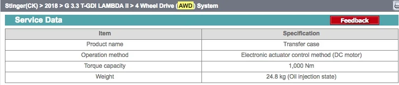

Is the trans really rated to 800 at the wheels or 800 NM (which would be around 590 torque lbs foot to the wheel)?.
Supposedly the transmission is rated at 1000nm or about 740wtq. This was posted by someone else on this forum a while ago and shows the torque capacity of the transfer case, but what the transmission is exactly is unknown to the public. Should be close since Kia likely wouldn’t make one a lot more than the other.4686E714-4E34-449E-B996-B4E3DC66F10D.webp
