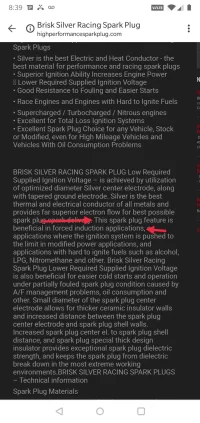

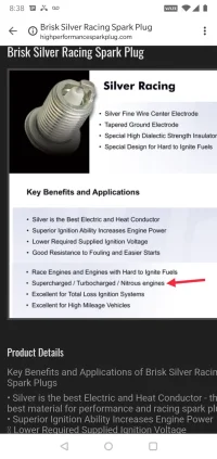

Also I don’t see in that article where they recommend their other plugs for FI engines. Can you please clarify so I can see it too?
The silver electrode is softer but it’s recessed and much larger than Densos or other iridium tip plugs. I was told they are expected to last 20k-30k which is similar or higher than most high performance plugs.
My one friend with about 450whp+ & 20psi+ has over 15k on them with no issues or wear showing. He any many others used Densos or HKSs and only got about 8k-10k before needing replacement so that says a lot about them imo.

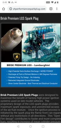

Here you go....
There is no mention of forced induction on the other, open tip design plugs. Take a look....
Hence, inferring that they're not recommended for FI. Also, the guy himself said, "Unfortunately, the standard LGS variants like the EOR14LGS design have a very large gap that is not adjustable and for applications that see cylinder pressures such as the stinger platforms it is not a great fit."
If you think about it, the only real "feature" that these plugs have that the others don't are the silver center electrode. That's pretty much about it. They say their ground electrode is thicker and more heavy duty, but it's hard to tell by the pictures alone; and they're discounting the fact that the OEM NGK and the HKS plugs have the Platinum chip on the ground electrode which helps keep the gap consistent and reduces wear on the ground electrode.

Thanks for sharing and clarifying that you were just inferring they weren’t recommended for FI engines. It actually doesn’t say that anywhere, but I see how you made that assumption.
Few things to keep in mind and reasons why the LGS plugs are working well in our Stingers. I’m not disagreeing with Brisks comments but the parameters and benefits of the LGS plugs do actually fit our engines.
First, the Silver Racing plugs are made for high output racing engines with hard to ignite fuels(alcohol, nitromethane etc). Almost all of them are extremely high boost forced induction and/or Nitrous engines. Our engines only run about 12psi(stock) to 20psi(tuned) and don’t really fall into those categories, at least not yet. Also all of the 4 recommended applications listed for that plug don’t apply to our Stingers.
Second, the beneficial plug feature you cited for forced induction engines actually refers to the silver electrode and it’s advantages as a superior thermal & electrical conductor. The LGS plugs share the silver central electrode and will have all those same benefits for our boosted engines.
Third, the LGS plugs don’t mention forced induction because as Brisk said they aren’t designed for tight gaps which most boosted engines need for easier spark to break through the air gap. However, since the LGS plugs use a hotter semi-surface spark discharge it takes less energy for the spark to glide along the surface of the insulator than to break through the air gap.
Also our OEM plugs are actually gapped around 0.032-0.036 so they fall into the proper gap the LGS plugs work well with. So between the more efficient and easier spark these plugs actually run very well in our engines.
Lastly, the multiple other benefits that the LGS plugs have do provide better fuel utilization and in tern more power in each compression. This definitely does increase throttle response & power which is very noticeable when switching to the plugs compared to Densos or the NGKs. I’ve driven both Stingers with these plugs before and after install and there’s no doubt they made a big difference in performance. I didn’t believe it at first myself either but after seeing & feeling the proof I can’t deny these are superior plugs in every way.:thumbup:

Or am I misreading this thread?
Did I read this right? Brisk (the plug manufacturer) is saying those specific plugs are not meant to be used in our car, but members here are telling other members to use them?
Lol that's what I read too. I was pretty dismissive of this brand simply because I had never heard of them before (NGK ALWAYS FOR EVERYTHING ((except Ford)). After reading the response from the company tho, I'm actually pretty interested. 15k to 20k miles isn't that big of a deal to me. My WRX had to change the plugs every 12k to 18k so nothing new.
There just not vehicle specific. I don't think any manufacturer how stinger specific plugs?...at last not yet?
Very interesting shit here. I think I'll have to try these.
I already explained above but if you read Brisks response they “generally don’t recommend” the standard LGS plugs for us due to their large gaps. However, their website clarifies that the LGS’s “generally work well in the applications where the recommended spark plug gap for given application is more than 0.032". Our OEM plugs from Kia are gapped between 0.032-0.036 so they actually fit that description perfectly.
Also the reason tuners suggest tighter gaps while using extra boost is to prevent misfires. But because of the patented semi-surface discharge and silver center electrode they take less energy and are more efficient at producing a spark so misfires don’t happen even under 20psi+ boost.
The LGS-T plugs with tighter gaps may work better for even higher boost conditions and know my friend is already in discussions with the owners of Brisk about developing them for our Stingers.
However at this point a couple Stingers already have and are testing the LGS plugs with great results even after 15k miles and 20psi+ daily driving.:thumbup:
The problem isn't that they aren't vehicle specific, the manufacturer listed different models that they offer that will work for our vehicles. The issue the manufacturer has with the plugs that are the topic of discussion, is that the gap is a bad choice for turbo vehicles.
What tune/piggyback are these guys running? jb4? Have they sent any logs to Terry? I have some Densos that will go in first, then maybe look at something like this..
