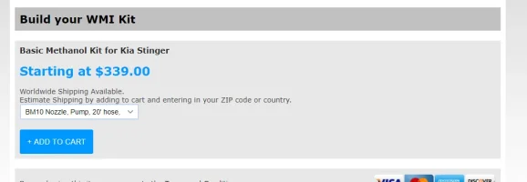

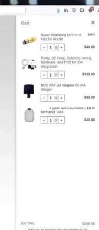

THATS WILD! im debating on buying the burger motor sports wmi! doesn't look bad or anything. might just f*ck around and buy it :whistle:
