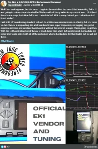

It should be mentioned that there is work on BEF maps that calibrate boost through the ECU happening currently.
They haven't been released yet but I've been assured that if you're a customer of the current maps through KJT, you will receive a revision with full boost control for free when they become available.
Any chance you can post where I can get in touch with this guy? Very interested in this, and have a bunch of Q's to ask.
It is... But that website doesn't achieve much or show much for that matter?

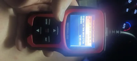

Ecu logs everything...
My scan tool tells me how many times the car has been started , how long i have driven with a CEL on and how long since i cleared the last CEL.
And this thing doesn't even scratch the surface like a dealers scantool will.
But i can read Max boost/ Max revs/ Max speed achieved etc...
It's all logged, only way to delete it is to swap with a virgin ecu and have it coded to your kilometres/ miles.
