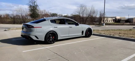

sure. this is the best I got at the moment. the last one is before I put the 245/40 tires on. it's with the OEM 225/40 on a 8.5 inch wide rim. a little too much stretch but still looked decent. The drop is enough to know the car looks different, but not so much it's slammed or looks non-stock. I've had H&R springs on like 5 previous cars, with a more aggressive drop, and the Ark GT-F are just much more comfortable, but still add a lot in looks and performance.
View attachment 67860View attachment 67861View attachment 67862
Those ark gt f springs make the car look like a whole new beast. Those combined with the sway bars should have handling on point. Thanks. If I did go with the oem tires and rims on my ride with the ark gt f springs until it’s time to swap tires would I be good ? I see the last pic you mentioned that.
Yes. Totally fine. It will still look good.
