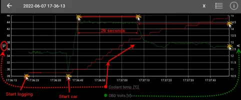

On my 2018 stinger (4 years old) - 92,392 kms- original AGM battery - in what I believe to be excellent condition.
After sitting at my work for ~9 hours, with no external accessories powered on (Dashcam not connected etc) - I decided to log the voltage (coolant temp shown only to show this was from a cold start). Car was parked & at idle RPM during the entire short log.
After just 26 seconds at ~14.4v, The BMS/AMS decided to reduce the voltage to under 13v (Battery management system / Alternator management system)
NOTE:
I don't have the no load battery voltage - as the logging setup I have only works with IGN on - so the beginning voltage of ~12.3 is measured with ignition ON

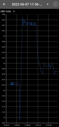

Exact same data as above - only voltage, higher resolution on the actual voltage. (shows 10.9v while cranking)
Lets hope anything plugged into the car can operate between 12-15VDC with transients like that.
