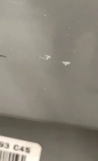

EDA7A468-35CB-4EFB-976F-022A92058C59.webp A2693EFE-9DB8-41CD-A9E1-9FB527BBF00E.webp
This is what happened today at my local body shop when removing the rear kia badge. They used a heat gun. There were no issues when removing the small “Stinger” badge. Now they are repainting the whole back piece...they also had to replace the GT and AWD logo due to repainting the rear.
Oh man, sorry to hear. I wish I would have brought mine straight to an autobody guy to do the badges. To see mine you have to be right up a nose away from the GT emblem and you can see the touch up just a little below it. Anyone know for sure if this is a fiberglass panel?
B83C0BC8-24C4-497C-A61A-1361C6DD7466.webp Yeah, the body shop is covering the cost to repaint the back. Plus the had to order OEM “GT” and “AWD” badges. What a process!
