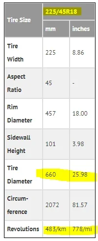

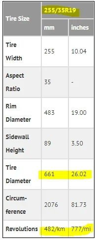

No you would need to replace the wheels as well unless you find 19" all-weather tires to mount. And replacing the 19" wheels with 18" wheels might cause a bit of confusion with the speedo although someone said the circumference was the same in which case it wouldn't matter.

The 19s have a shorter sidewall than the 18s due to the aspect ratio, which is why the diameter on the two is nearly identical - many prefer that look (more rim, less rubber).
