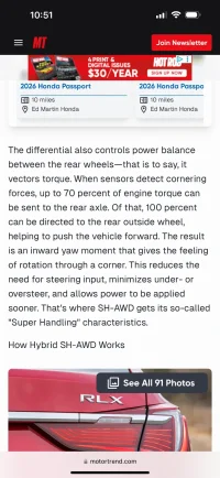

The Acura system was a little more advanced than that.
It's true, the Type SH is more advanced.
But I much prefer driving my AWD Stinger everyday.
Just personal preference I guess.
That is interesting, I'm assuming they just continued to add features to subsequent generations. I guess you could claim "100% of axle torque to one wheel" by adding a lockup diff (with an asterisk that you only get 100% torque to one wheel if the other has zero grip), but putting that behind a FWD-based system trying to siphon power to the rear axle via clutch packs just seems wrong.
And torque vectoring to induce a yaw implies it goes a step further...you'd need the ability to overdrive the outer wheel when the inside wheel isn't necessarily slipping, which is a bit more complicated mechanically. At that point why not face the engine & transmission the right way and give it a proper drivetrain layout to work from?
