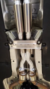

I didn't have the vibration issue but the stock Ark did have too much drone for me. My muffler swap seems simple compared to your mods (but was still about $500 US). Swapping the muffler knocked down volume and drone by about 25%. I'm not a believer in needing back pressure but it does require some to knock down the sound / drone.

I didn't do sound deadening until after the muffler swap to prepare for my SSR mid pipes.

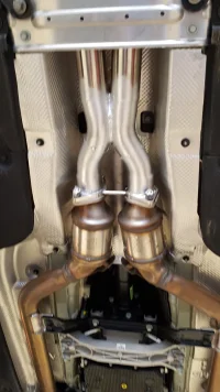

Do secondary downpipes increase the sound with OEM catback? can it create any kind of drone?
Anyone happen to have done this and have video clips available for sound? Sounds like an easy solution for someone who wants just a bit of extra oomph rather than something over-the-top or something ultra expensive like an electronically adjustable one
