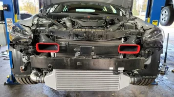

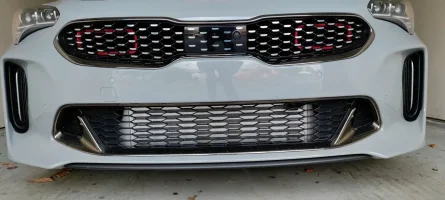

I have the JA air scoops which are no longer available but functionally the same as the other ram air ducts. I've never had any water touch my air filters (I've driven though heavy downpours), dynos won't show any gains but doing pulls from highway speeds 60mph+ seems smoother. The added induction noise from the aFe enclosed intakes are nice as well, not so much noise from the inside but it's loud from the outside.
