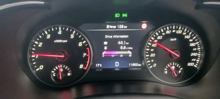

Castrol 20W50 getting poured in tomorrow... Shall be interesting to see if it is any quieter or the economy is much worse if at all?

Can confirm economy very much the same, is it any quieter?
No i don't think so, will change it again in 5000km's and try some 10W 40 for Summertime ;)
