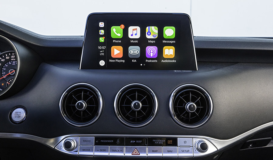

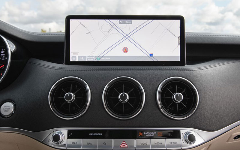

Hi everyone,
Was curious to see if anyone has successfully upgraded their infotainment screen and associated hardware from the 2019-2021 8" to the 2022+ version's 10.25"?
I would guess that, if it's possible, it would require at least the following:
  • New screen and mounting hardware
  • New screen base plate (assuming it would fit in the previous version's layout)
  • Possibly new radio / head unit, assuming that the video output is not interchangeable
  • Any required changes in wiring harnesses between the two versions
Anyone looked at the part numbers needed, or taken the dash apart on their 2022 Stinger and take photos?
Thanks

They changed the dash slightly in the newer models, will that need to be changed as well?
For sure the screen mounting component, the hangers have different diameter and the top decor that covers the screen base (piano Black on the new version).
The connectors have different wiring, screen needs a coaxial cable with a plug that I can't find (it's not the same diameter as FAKRAs in the Head unit).
I can't go any further unless I wake up the screen, but no idea what signal is needed to do so. When +12V is connected, it uses just 0.06A, so it's in standby mode.

Seeing how many owners have posted lately about their 8" screen delaminating (typical from upper right hand corner, I'll gladly keep my 7" with external bezel. Yeah it isn't the nicest looking rig, but far less unlikely to suffer similar fate. It does the basic stuff I need a screen for, nothing fancy. These days, 95% of the time, I have it on Android Auto, and the new Coolwalk works quite well on the 7".

As for the 8", our G70 comes with it, While the integrated bezel looks a lot more sleek, it really doesn't offer anything I can't live without. With Android Auto, I don't really miss many of the higher trims' built-in features, like GPS nav. Anyhow, it's good that you kept the 7" screen. It's good for a backup... just in case you need it.
