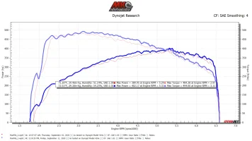

Here's before and after when I installed my high-flow downpipe primary and secondary combo
Jb4, Big Bore throttle body, borla Cat-Back, primary downpipe combo, K&N intake,BMS intercooler, 93 octane,

Care to elaborate a bit more for me as I'm looking extensively. Because the gain wasn't tremendous and the overboost issues, you think just replacing secondary downpipes are sufficient and not primary? With a tune, are we really modifying any parts of the exhaust primarily for sound more than anything else then?
