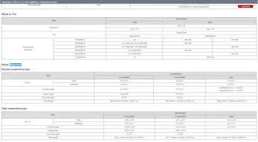

I'm interested in this as well. I've an 18 GT2 AWD that I got new in spring of 2019. Put about 55,000 miles on it in the last two years, after having relatively low mileage previously so I'm over 87,000 now. Have a potential 175 mile round trip commute if a job offer comes in. Would put me around 120,000 miles by next summer.
I've had no real issues besides tires - the dealer and alignment place each initially did several alignments for rwd not awd, so until ~30,000 miles I burned tires every 8,000 miles because the fronts were always thrashed. On me I guess for not being insistent enough about asking specifics about the alignment settings. They're still convinced everytime I come in that the car is RWD based on whatever their vin lookup tool is.
The difference is extremely minor between specs for AWD vs RWD
