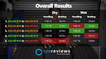

On the topic of Square or Staggered for the track I found a very interesting video:
TLDW: Keep in mind this was tested on a lower HP BMW 320
And some comments on the narrow front factory wheels:
I think the reason why BMW puts narrower tires on the front of the car from the factory has to do less with performance and more with safety. Most road cars are engineered to understeer by design so that they are more manageable in situations that result in loss of traction. Understeer is far less scary than oversteer for the average driver.
225 Front and 255 rear will be less likely to aquaplane than having 255 all round.
