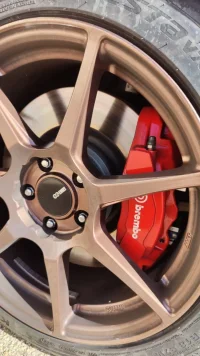

I have amassed quite a few spacers (3, 5, 8, 10mm) and wheels of various offsets (34, 35, 38, 39, 40mm), so it is easy for me to experiment with different offsets to get a feel of the chassis response, then correlate that with the expected chassis behavior at -ve, 0, and +ve scrub radius.
For example, I have been daily driving mostly on my 18x7.5 ET39 with no spacers. This has 5mm more negative than the stock 34mm. As expected, the car's steering effort is a bit higher, but the front end felt like it tracks better, especially on corner exit when returning to straight. biggest difference is when hitting standing water, which around these parts is a regular occurrence with flash floods. Overall, probably not my favorite for a "fun" setup, but excellent for safe everyday driving on public roads.
OTOH, for AutoX, I typically run 18x8.5ET40 or 18x8.5ET38 with 10mm spacers. This changes effective offset to 28 or 30mm. The biggest difference is the steering effort, which is dramatically lighter than my street setup, even though I run wider and sticker track compound tires. Turn-in is faster and steering feel is enhanced (this one is also affected by other factors). I avoid running these tires in the wet, for obvious reasons, and the track is typically fairly smooth, so the negative effects have less chance of getting me in trouble. Center finding on corner exit is less precise, but with AutoX, you are turning constantly, so that's not a big deal either. For running Track Days at higher speeds and longer straights, I might dial the offset back closer to stock 34mm.

The real conundrum to me, is if I want to go 245 up front staggered, I'd need to go 275 rear, and that would be on 9.5" & 10" rims respectively, which feels like too much deviation from the factory 8.0 & 8.5, and too much tire at the rear (can that be a bad thing?)
Which is where the idea of identical tires on wider front rims and narrower rear rims came from.

So assuming the stock configuration of stretch at the front (225 on 8.0) and pinch at the rear (255 on 8.5) is the goal, it would mean a 245 square setup would need 9.5" up front for the stretch, but a more pinched 8.5" at the rear. The logic seems to work, but wider rims at the front feels off
Too many folks let their pre-conceived notions color their judgement. There is nothing wrong with wider rim up front. Remember from above example of the M3, which has 275/40R18 on 18x9.5 up front.

G70 is that the front has trouble clearing
aftermarket wheels wider than 8.5". Not at reasonably affordable prices anyway. If I could find an 9" front that would fit, I would be running that in a heartbeat.
